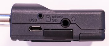

Here's the left side of the unit...
Which has the SD card slot with cover, a headphone jack ( so you can monitor your recording if you like ), a USB connection to transfer your recordings, and a hole for the wire belt-clip.

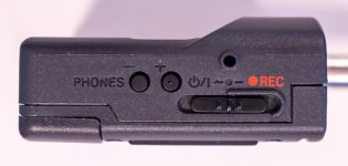

Here's the right side of the unit...
Which has the volume control for the headphone jack, the ON/OFF and RECORDING START/STOP switch, and another hole for the wire belt-clip.
