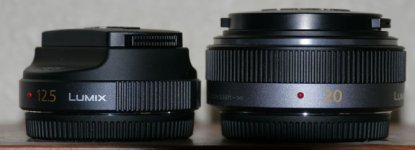

Okay, first things first – the lens itself. It's tiny. Ridiculously tiny and featherweight. How tiny? Let's just say that the Lumix 20mm f/1.7 “pancake” lens looks big next to it! The 3D lens seems like it's about half the weight and even thinner than the 20mm.
And, it's entirely and completely “fixed” in all ways – fixed iris (f/12), fixed focal length (12.5mm), fixed focus (anything from two feet to infinity is in focus). It's a very minimalist lens. Don't let the 12.5mm focal length fool you though, this is not a wide-angle lens! While its focal length is technically 12.5mm, you have to take into account that it's two lenses recording to (less than) half the frame each –so it's as if it's 12.5mm on a 2/3” sensor, or actually probably more like a 1/2” sensor. The actual field of view is more on par with a 35mm lens on an m43 camera – meaning it's a bit of a telephoto; that'd be about equivalent to 70mm on a full-frame 35mm stills camera.
