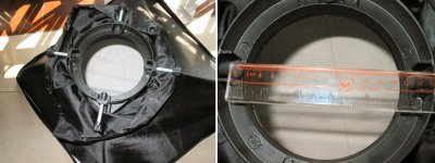

Well, the main question to ask with this particular fixture when you want to know if it will work with a softbox hood is "what is the inner diameter of your speedring?" The CL-SFT1 was designed to work with a 5.5" inner diameter or larger. Why? Because those 200w 8U bulbs (which is primarily what this is made to go with) have a base diameter of about 5.3" so its already very close. 5.5" or larger was about the only way to accomodate that bulb and still have the speedring be a "speedring." What I mean by that was that another way to go was to make a softbox fixture that would have a smaller diameter and could fit in just about anything and then have to screw the bulb in after you attached the hood to the fixture. Then its not such a speedring--if you see my point. You can't just slide in, attach and go which is supposed to be the idea.
How to measure speedring
Here's a picture showing how to measure to be sure if your inner diameter will work or not. Its just measuring from the end of the thumbscrews. I took a quick look to try to find your softbox on the web to see what its specs were but I can't be sure--there seem to be so many options on Chimera softboxes--so the only safe way to be sure is for you to measure the speedring. Just remember 5.5" or larger and your in... Click on the picture below to make it bigger.
I just noticed something else. If the softbox you have is the one that is only 12" deep then another issue is that these 200w bulbs can stick out from 11 to 12" (I have a 250w one I got in China which is really sticking out almost 13") so you're right at the edge of where the diffuser material would be. Now, it may be the case that you won't need the diffuser material. I still use mine sometimes when I need to tone down the light a bit. So its at those moments your glad to have a bit deeper softbox when you're using these bulbs. By the way, here is another 200w bulb but its pricier. They claim to be CRI of 90 and color temp is 5500K. Now you have two choices--but I don't have experience with this one so I can't tell you if its good. The other thing to look at on these is the ballast and whether its good and doesn't flicker. Most of the ones I've tried don't flicker--but I have found a couple in China which do.
