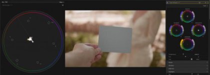

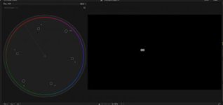

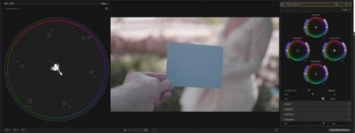

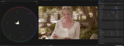

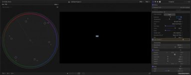

Not sure what I am doing wrong here. I shot a gray card at a wedding, lined it right in the middle of the vector scope in fcpx, and my image still looks off. What am I doing wrong? I think the final image looks way to yellow...
EDIT: I just remembered this was shot in Panasonic V-Log L so maybe vlog just sucks.....? I have heard it has sort of a pinkish hue. Still looks yellow too tho....
er, the area of constant hue has to fill the frame. the camera has no way of detecting which bit of the picture it's supposed to use as a reference. You either need to zoom to fill the frame, or move the camera closer.

Skin tones look a little magenta but not all that far off.
Since you have a grey card in the clip ... why not use it in post. Use the white balance dropper to sample the
card and see if that changes your temp and offset.
