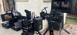

About to start up a feature with two DVX100's and felt like if there was anywhere I was going to post about it, it had to be here!! Used to frequent these forums when the DVX was the camera of choice for many of us, very fun to come back to this camera later in my career. It's a low budget horror movie using MiniDV and video glitching as a strong stylistic choice. Shooting on 2 of the DVX100's and have a bit of camera support to turn them into more modern cameras. Recording both to tape and the Atomos Ninja V and have wireless video on both as well. Also have dummy batteries to power the camera and all AKS off of gold mount. Using the nucleus as well so we can do a little bit of steadicam in the film.

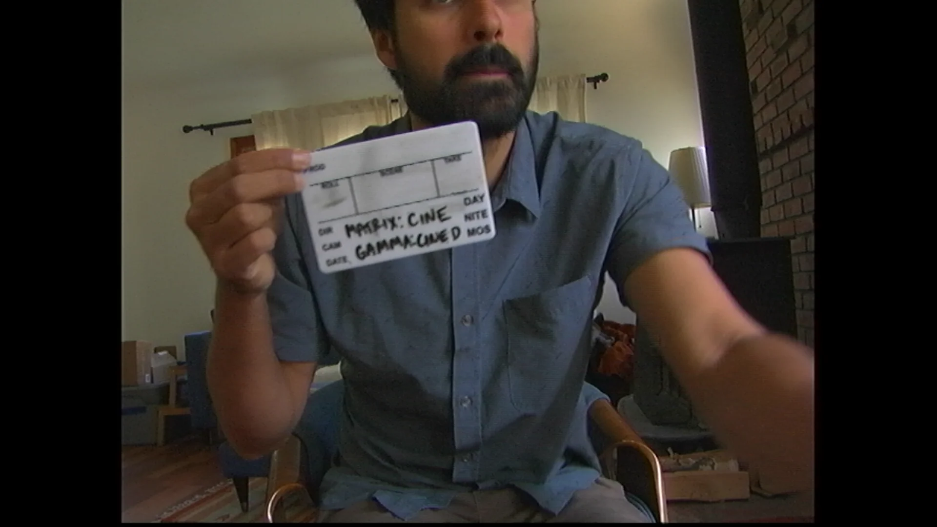

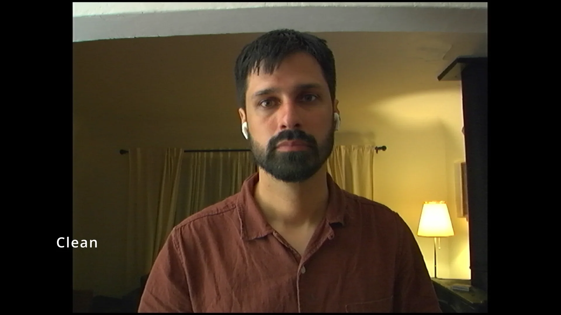

Also this test helped me to realize there was something wrong with the S-Video cables I bought. It was introducing scan lines and some sort of fixed pattern noise into the footage. Luckily I noticed and was able to swap the cables which cleaned up the footage nicely. Now that I know what to look for, I think I should be able to catch this problem in the future. Not to mention I ordered 6 additional S-Video cables, plenty of spares!!
Bad S-Video Cable
New S-Video

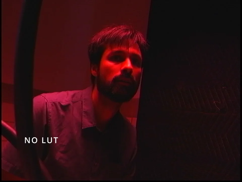

Well we just finished our first week of production and the DVX is really putting out some great stuff. Its so interesting working with it alongside all these modern amenities like wireless video and RGB LED lights. We have had a number of scenes with red light so I worked with my colorist beforehand to figure out how to best make that work for the DVX. Basically I shot a test with an Aputure 600C that we planned to use during production and I did a primary red color with 25% - 50% - 75% and 100% saturation and tried to match this reference.
We ultimately landed on doing 50% saturation and then he built a LUT that brought it to a less crazy place. I think with some haze added this will get us pretty close.
We also looked at building a show LUT and adding film grain to show the director what that might look like when we get to final color. I really liked the addition of 16mm film grain, I think between that and the softening filters it got us an interesting image. Our show LUT is pretty basic, honestly it really just brought some colors down as some of the more saturated colors would get really punchy. I'm just applying this LUT on the Ninja for viewing purposes and outputting it to our production monitor.

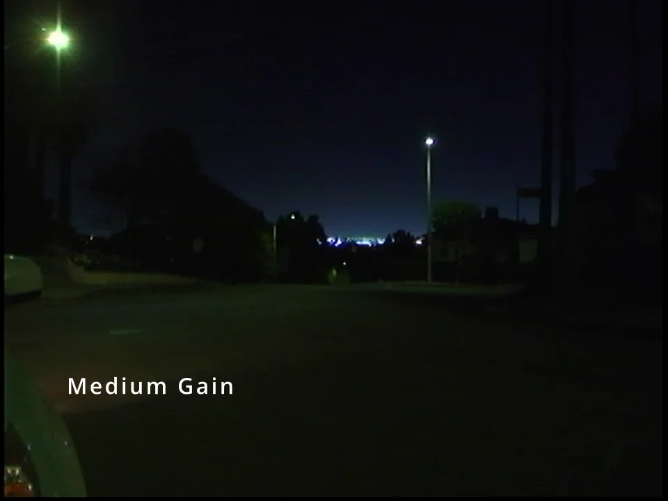

I also did some gain tests that we looked at, I wanted to know if the high or medium gain was usable for the look of the film, or if it was something better done in post.
Ultimately we tried to bring the low gain version up to the brightness level of the high gain and couldn't do it without introducing significantly more noise. Realized it was better done in camera. Both myself and the director were actually into the high gain version as well as it feels like it fits the look.

I noticed that the city lights were pulsing pretty rapidly in your gain test (it's also happening with the lamp in the Night Interior test). Any idea what's causing that? I didn't have extensive experience with this camera, maybe only 2-3 shoots. But I didn't remember seeing anything like that.
Thats interesting and honestly something I should test a little bit more. I have noticed that being in AF will cause high contrast areas to pulse rapidly, I wonder if I was in auto focus. We haven't shot any night exteriors with high gain yet, so haven't had a chance to see it yet.
