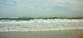

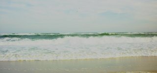

Here is a slightly overexposed clip in order to amplify the results. It's in FCP X but all NLEs do the same thing (just some have more tedious control for certain tasks than others, like Resolve with pinpoint color manipulation).
I used ALEXA's famous LogC LUT which is known to really blow out every camera but its own.
In order of appearance:
(1) Original.
(2) Only the LUT has been applied (which naturally overexposed the clip even more).
(3) The exposure has been adjusted AFTER the LUT (exposure setting, -40).
(4) The exposure has been adjusted BEFORE the LUT (exposure setting, -40).
Visually, you can see the whites have turned into paste in (3) and all information has vanished.
(5) The waveform is immediately clipped (with exposure adjustments after the LUT).
(6) The waveform is naturally producing a sine wave (with exposure adjustments before the LUT).

NoBro the waveform tells the story, I see, thanks.
