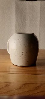

Reflections.
Id generall be a fan of bedsheets, 8.8 gridcloth or poly 8.4 or some other form of 'light tent'
Ive also shot light tent with the back open - so the subject has soft light but the background is treated seperately.
Interesting the 'reference' shot..
A super hard light far back will just make a pin sized highlight - something Id not thought of. Also this pin might be easy to whack in post.*
So often with 'references' we see that the originator did something really quick dirty and easy!
I would not be dulling spray a million quid vase or even a $5 wine glass. I think dulling spray shows that the lighting design was wrong.

Reflections.
To be clear, when we're talking about reflections are we talking about the glare from the keylight? Because there's only one vase that's truly reflective (the dark one). In it I can see the seamless bounce and the key light and the white ceiling. Can't see myself except in the very last shot I notice now that I see myself crossing from camera to light. That's a stupid oversight, it would have been easy to use a different part of the shot.
As far as the glare goes, I'm conflicted. The reference shot they gave me had hard light, and my approach was intended as a sort of compromise. I wanted it to feel like a window, and it's about that size. I like the zing and contrast it adds. I don't like it when it covers an important detail.
And in general, this client enjoys showing the production in their films. It's part of the "edgy" directive. For example, they're fond of an interview cutaway where we see the entire set. And if we see production tools reflected in the artwork, it's often accepted. If it's super distracting or we can see the cameraman's face, it will probably get rejected.
Yeah the photographers get away with murder by compositing together different lightings from different shots. I've shot vases for this client before and tried the hard light with pin highlights and they hated it and instantly wanted it to go larger and more diffused. If I had been able to edit out the highlight altogether, maybe I would have had something... But I wouldn't bet the farm on that without running a specific test for it.
My thinking for the lighting if I did it again was larger reflector on fill side (this was about 8x8 at a distance of about 6' so probably about 90-degrees of surround. I'd move that up to about 135 degrees or more).
And I'd go larger source on the key side. This was about a 4x6' illuminated patch of unbleached muslin cut by floppies on top side and bottom. (Behind the muslin is aputure 1200d with light dome and 2 layers of diff into a 4x4 silk.) It's about 8' away from the subject and probably about 15 or 30 degrees of surround. I don't think I would go more than 45 or 60 degrees of surround or I kill the low-key sidelit drama from the reference shot, no? But generally speaking if I could enlarge the key so the brightness of the glare comes down I think it's a good thing.
I guess people are saying it should be a gradient down from bright to dark. That's what I would try to do with the large reflector. But I think the amount of glare and obscuring of details is wholly dependent on the intensity at the brightest part of the light source, no?
I guess.. the white oblong.
Its not a reflection like seeing the cam op in the talents mirror shades.. but to me it is still a "reflection"
With an almost light tent approach one would not get that.
Hmm I think I see the point. Here's a test with amaran 60x s into paper towel roll wrapping around mug
On the rear left side where the paper towel wraps around there is no line where the light cuts off. But on top bottom and near side there is
So in theory if I had a large piece of diffusion, maybe 12x12, I could hit it in the middle and have it fade away to nothing at the edges and then you don't notice the edge of the iight. Right? Or no?
But ideally it would be a single piece that curved gracefully in both directions... much like the light tent products being sold...
But if I just hit it from one side then in theory I can still get low key and steep falloff
Im not quite sure what you are saying.. trying.
I think you are describing a massive light tent unevenly lit to create shape.
indeed.
How to do that? various options none perfect :)
indeed.
I think that's what I'm saying. You take a hard side light and you stick a light tent in the way
how would you do it?
simple way seems as big of a flat surface (like 12x12) as possible. Not really a light tent, but you should still get some gradient fall off out of it. Of course, you can put together multiple pieces to make walls/ceiling, but from my paper towels experiment it seems like the seams will be apparent in the reflection. less sexy
