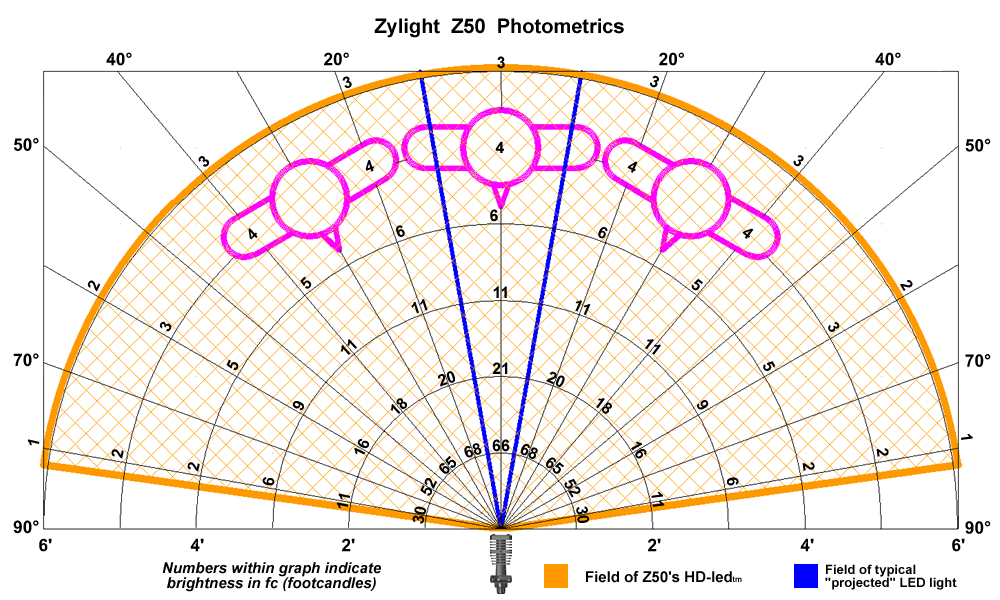

    got an idea of how bright the z50 is now
    after looking at these charts
    http://www.atscomms.com/Sales/Produc...otometrics.gif
    http://vidled.com/warmLED_specsA.jpg
    http://www.lowel.com/ilight/i_b.html#info
    the last one is the only one i've worked with.
    so if the z90 is 4x the z50 then it should be about half the lowel (when in flood) at 1.5 meters, pretty good considerring it's large even spread.

        Litepanel mini flood puts out more than 2x Zylite 50.
        6.7FC @6 ' Litepanel
        3FC @6' Zylite 50
        I'll wait for the z90. I wouldn't compare LED lights to lowel pro light. apples vs oranges.

          Not so fast, the Z50 has a beam angle of 160°; you are only listing end-footcandle withgout taking the beam angle into account.
          The Z50 "puts out more" light than the one you mention, but it does it over a wider area, so the end-footcandles at any given point may be less, correct.
          Z90, by the way, is slightly narrower, but not by much.
          Total lumen output of the "older" Z50 is about 300lm, and almost 900lm for the Z90 (with a slightly narrower beam; approx. 130° vs. 160°).
          The Z90 is the brightest LED on-cam light by far, I'd say (of course it also uses much more power than other lights at full brightness...).

            well i was just using those charts to get an idea of how bright "x" amount of foot candles is, and put them here in case anyone else was interested in the comparison.
            i've just recently shot some stuff with the lowel which turned out great, but my uni has it hooked up to a small car battery, so it gets pretty heavy and cumbersom, also it only lasts about 1/2 an hour, and it's brightness falls rapidly within that time.
            monkeyking, i can understand that led and somthing like the lowel are very different, but as i've only used the lowel i'd like to hear how?
            is it just beam angel and even spread vs spot?

                lowel pro light (I own 2) is a single point source enhanced by a focusing reflector behind the bulb . That reflector adds a lot of "punch" to the light - from flood to spot patterns. Hence, you can get a lot of light further away by spotting /focusing the beam of light.
                LED lights brightness drops rapidly within a short distance. No adjustable beam spread. LED lights are good for close work especially as fill light. Look at the charts, see how footcandles/lux drop dramatically as distance increases.
