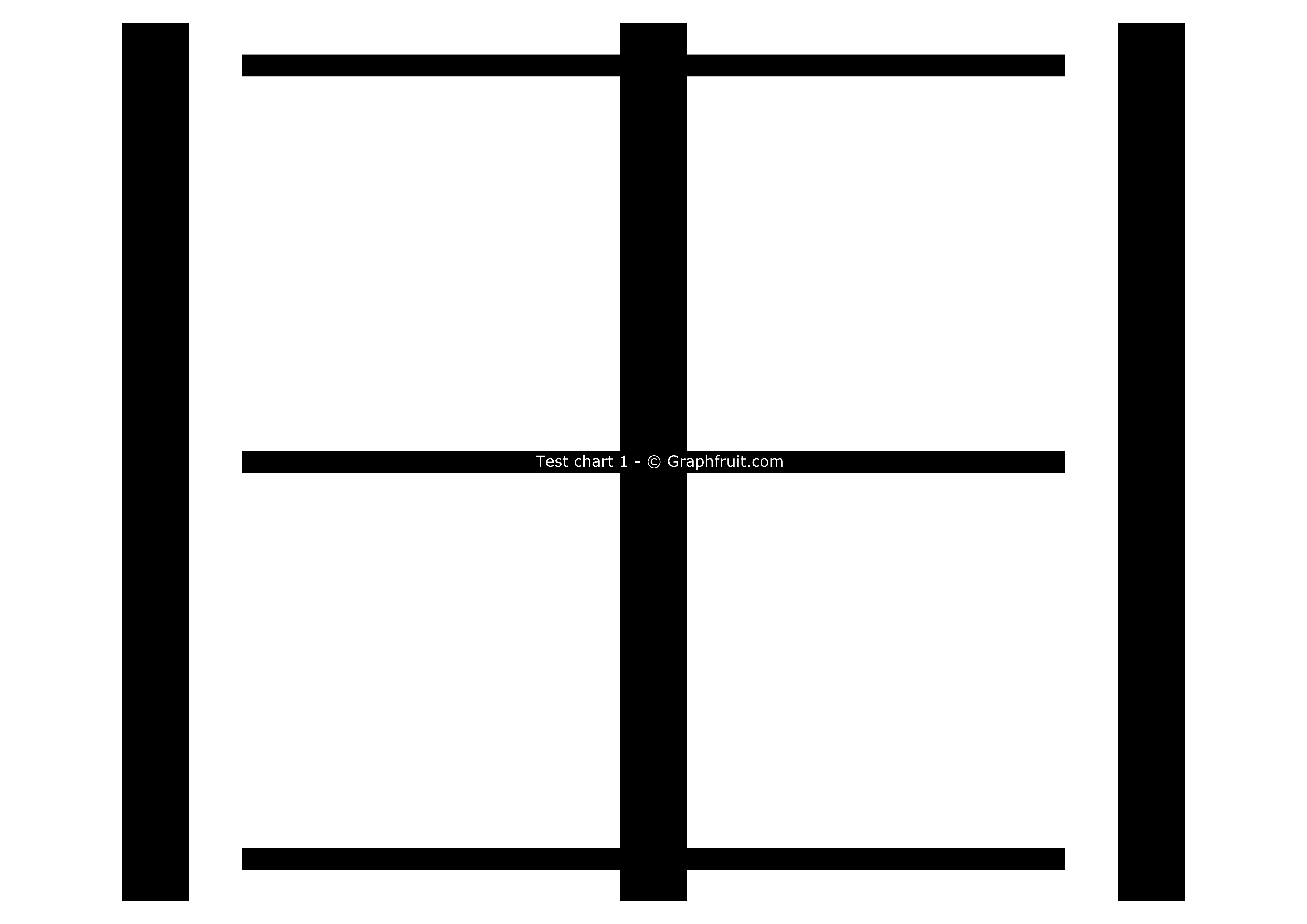

    I'm developing a batch program for Nikon D90 (and the upcoming D5000) movie clips which will remove the "stair-stepping" and minimize the rolling shutter lag (Nikon are you listening?!?), outputing a lossless video file for further post-processing.
    Currently the main features are:
    Nikon D90 Stair-step and Rolling Shutter fix batch script
    - Batch processing of all video files in the working catalog
    - Stair-stepping removal acc. to Lee Wilson's fix
    - Specific rolling shutter fix - (yet to be optimized)
    - (Optional) stabilisation to eliminate shakiness when hand-held
    - Output in lossless (Huffyuv) video codec - (yet to be optimized)
    Test 1 - Before and after:
    http://www.youtube.com/watch?v=yLL46767KqY
    My batch script is currently in an early testing phase and still needs quite a lot of optimization.
    Could anyone contribute in the development by sending me some wobbly video clips,allow me to further optimize my settings?
    My Nikon D90 is currently on service so I don't have enough video material to further test my script. Please upload the original footage w/o any postprocessing using a filehosting service such as RapidShare. I'll test my script on your video clips and I'll send you the fixed clips back to you so you also can evaluate the result.
    Due to the way the rolling shutter behaves on the D90 it's not possible to fully eliminate the problem, but at least minimize the problem mostly when panning horizontally. On the other hand fixing Nikon's terrible scaling technique, that produces "stair-steps", works very well (huge thanks to Lee Wilson and other dvxusers).
    I've prepared a simple test chart so it would be great if someone could print it out (A3 or A4), set up your camera on a tripod and put the chart up on a wall in a bright place and do some panning back and forth at different speeds, preferable with a zoom lens. Also then some up and down seperately and some diagonal movement.
    Test chart 1:
    http://www.graphfruit.com/wp-content...graphfruit.gif
    // Adrian Graphfruit
    http://www.graphfruit.com/scripts/nikon-d90/
